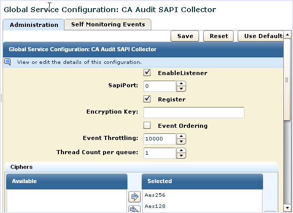

  3. Select the SAPI Collector service.
    This picture shows the CA SAPI Collector configuration dialog.
  4. Select the EnableListener check box and set the SapiPort value to a value that matches what CA Audit uses.
    The default CA User Activity Reporting Module value, 0, uses the Portmapper service to map the ports. If you have a port defined in CA Audit, use that setting here.
  5. Accept the other field defaults, and scroll down to the list of Mapping Files.
    If you select the Register check box, specify a SAPI port value.

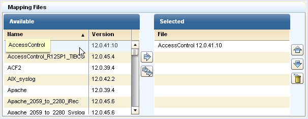

  6. Add the Access Control mapping file entry if it is not present, and remove the other mapping file selections from the list of Selected mapping files.
    This picture shows the available and selected mapping files for the CA SAPI Collector service configuration.
