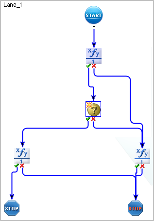

To become familiar with the sample event/alert out process
The name of your process and path appear in the main pane.
A model similar to the following appears. This example model contains minimal requirements for CA User Activity Reporting Module.

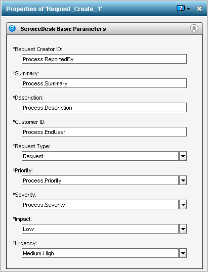

The Request_Create operator passes the data returned by the action alert query to your target product (application). A similar operator is required for any process that is to be run from CA User Activity Reporting Module.
BasicParameter = Process.LocalParameter
Note: Local process parameters are the Event/Alert Output Process Parameters you add to CA User Activity Reporting Module when you configure CA IT PAM.
ServiceDesk Basic Parameter |
Local Parameter |
Service Desk Field |
Notes |
Request Creator ID |
Process.ReportedBy |
Assignee,Reported By |
A valid "Contact" in CA Service Desk |
Summary |
Process.Summary |
Summary |
(Leave blank) |
Description |
Process.Description |
Description |
(Leave blank) |
Customer ID |
Process.EndUser |
Affected End User |
Priority |
Process.Priority |
Priority |
1-5 |
Severity |
Process.Severity |
Severity |
1-5 |
The following example shows valid local parameters for ServiceDesk Basic Parameters. The entries are case-sensitive. That is, Process.ReportedBy must be entered exactly as shown with a capital "R" and a capital "B" for example.
if (Process.Priority == 1) Process.Priority = "pri:504"; else if (Process.Priority == 2) Process.Priority = "pri:503"; else if (Process.Priority == 3) Process.Priority = "pri:502"; else if (Process.Priority == 4) Process.Priority = "pri:501"; else if (Process.Priority == 5) Process.Priority = "pri:500";
if (Process.Severity == 1) Process.Severity = "sev:800"; else if (Process.Severity == 2) Process.Severity = "sev:801"; else if (Process.Severity == 3) Process.Severity = "sev:802"; else if (Process.Severity == 4) Process.Severity = "sev:803"; else if (Process.Severity == 5) Process.Severity = "sev:804";
Process.ResultString = "Request " + Request_Create_1.newRequestNumber + " created in CA Service Desk.";
Process.FaultString = Request_Create_1.SoapErrorResponse;
