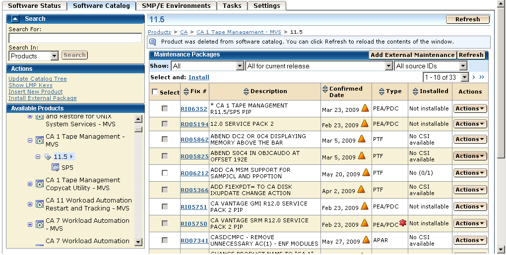

  3. If the information indicates that maintenance is available, click the Release Name link.
    The maintenance packages are listed, for example:
    The screen capture shows the Maintenance Packages section for a product release.
    Red asterisks identify HIPER maintenance packages.
  4. Click the Fix # link for each maintenance package you want to install.
    The Maintenance Package Details dialog appears, identifying any prerequisites.
    Click Close to return to the Maintenance Packages section after you review the information for a package.
  5. Select the maintenance packages you want to install, and click the Install link.
