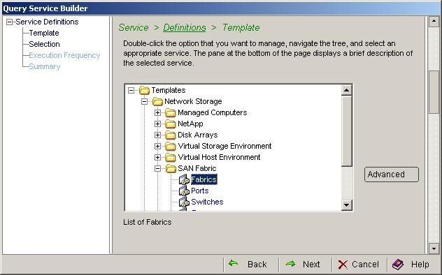

- Click the Configuration menu and then New in the Query table. The Query Service Wizard opens. From the Query table main menu, select Configuration, New. The Template dialog opens. Expand Templates, Network Storage, SAN Fabric, and select Fabrics. Click Next.

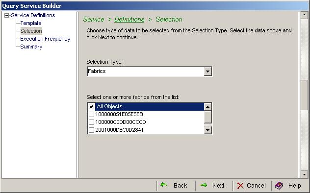

- Select Fabrics from the Selection Type drop-down list and select All Objects check box from the Select one or more fabrics from the list. Click Next.

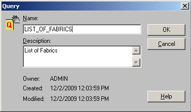

- Enter a name for the service in the dialog. You can also provide an optional description. When you finish, click OK. The service executes or saves depending on what you selected in the previous dialog:
