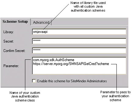

The following diagram is an example of an authentication scheme configuration defined on the SiteMinder Authentication Scheme Dialog. The Authentication Scheme Type is Custom Template:
To configure a custom authentication scheme on the SiteMinder Authentication Scheme Dialog, access the dialog box, click the Advanced tab, and select Custom Template as the Authentication Scheme Type.
