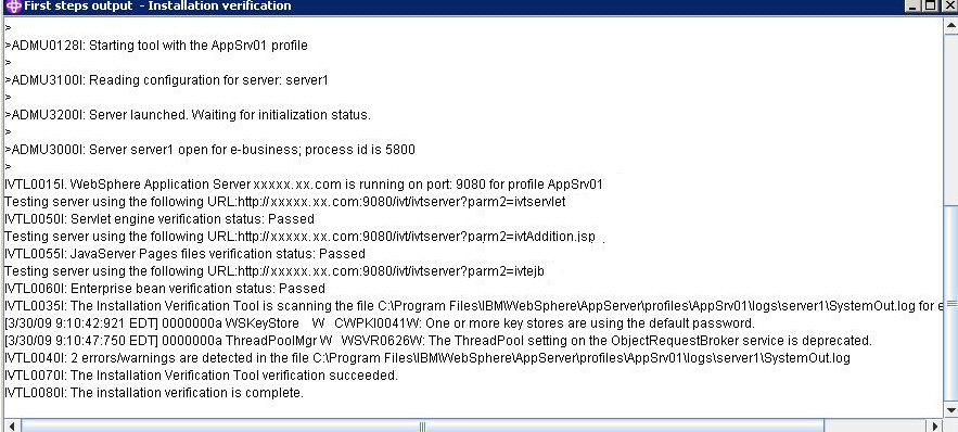

Once the installation is complete, the First steps utility displays.
The result of the install verification displays as follows:
