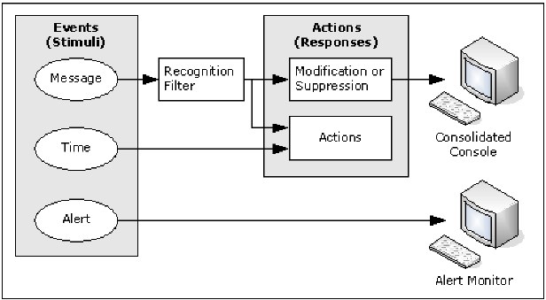

The following illustration shows how EventView works.
This illustration shows how EventView works.

Rules are grouped logically into rule sets, which define how an event is processed and what actions are taken in response to an event that is not related to a resource. (Resource-based events are handled by ResourceView.) An event can be a message or a specified time.
