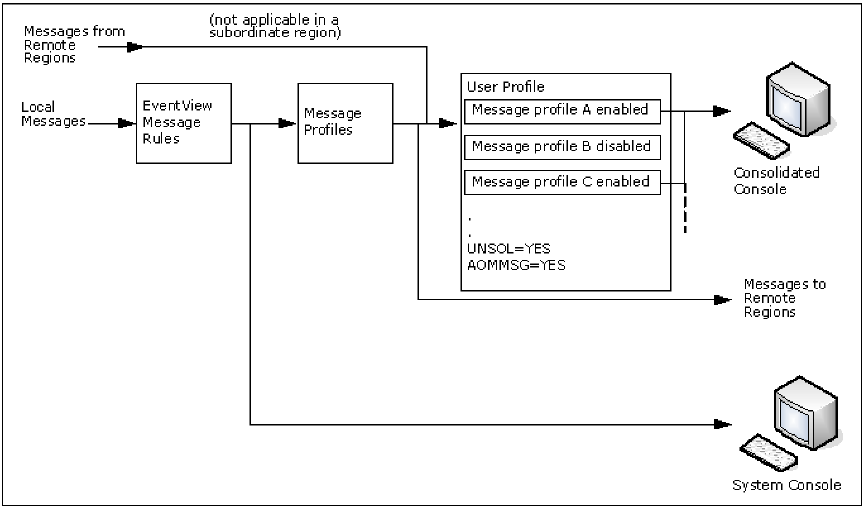

With message consolidation enabled, the message monitor becomes a consolidated console. Using the console consolidation facility, an operator is able to monitor messages from one or more systems on the consolidated console.
You use EventView message rules to preprocess the messages, for example, suppressing or highlighting the messages. You can then use message profiles to select the type of processed information to display on the consolidated console. For example, you can define a message profile that selects messages from a particular system. You can selectively enable profiles to customize the view of monitored events, for example, VTAM messages only.
The following illustration shows how messages arrive at the consolidated console.
This illustration shows how messages arrive at the consolidated console.
