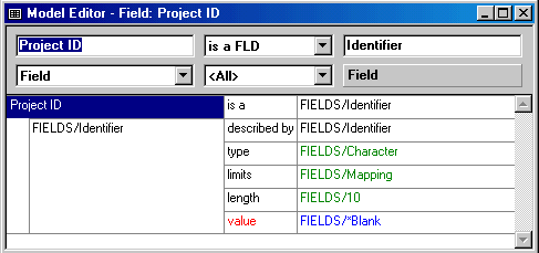

  5. Click the Two Levels toolbar button to see more about what an object inherits from its ancestor objects.
    The Model Editor shows another level of detail.
    Use Inheritance to Define Field Properties (4)
    Now you can see that Project ID has inherited a data type of character and length of 10, along with the value *Blank (which you saw in the Object Browser in Step 7).

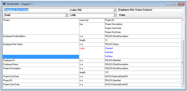

  6. Click the Refresh toolbar button (on the main toolbar, not on the Object Browser).
    Your Model Editor should look like this:
    Use Inheritance to Define Field Properties (6)
    Inheriting from DATE/CheckedDateISO gives the fields functionality to ensure that end users enter valid dates.
