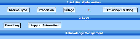

  2. Locate the blue area of the form in the Design view that contains the first numbered label.
    If you prefer Source view, the notebook area appears between the following line of code:
    <PDM_MACRO name=startNotebook hdr=cng_nb>
    <PDM_MACRO name=endNotebook>
    The following example shows this notebook area in Design view that begins with the numbered label titled 1. Additional Information:
    This area of the form lets you modify notebooks in the design view.
    Note: In CA SDM r12.6, a notebook can contain nested tabs. In WSP, a high-level tab (a tab containing other tabs) is named a tab group. WSP displays a tab group as a dark blue solid bar that spans the entire blue notebook area, with a numbered label in its center. A low-level tab (a tab that does not contain other tabs) is named a tab. WSP displays low-level tabs as rectangles with rounded corners.
