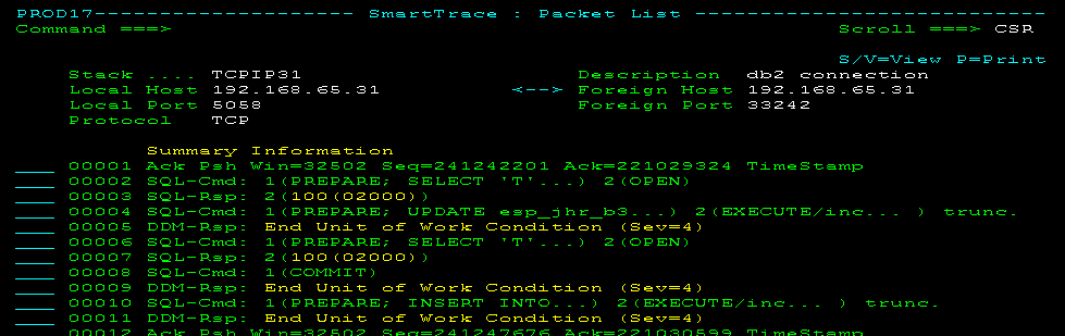

On the 3270 interface, you can use the following primary commands to change the contents in the Summary Information column:
(Default view) Displays the SQL commands and responses in a DRDA packet. If there is no SQL information, the Distributed Data Management (DDM) commands and responses are shown.
This view is useful for troubleshooting SQL application issues. When a response shows an SQL status code, you can display an explanation of the code using the SQL line command.

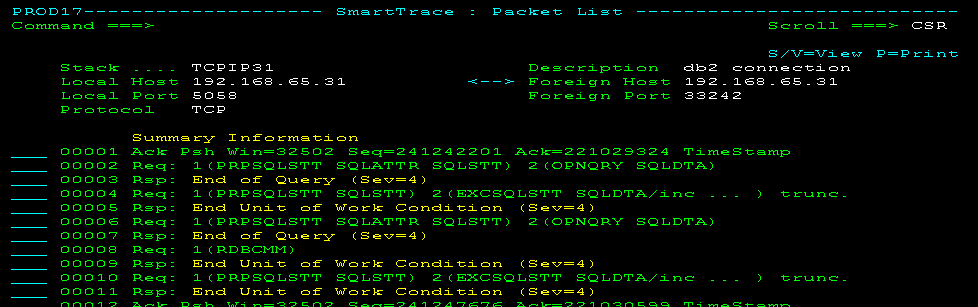

Displays only the DDM commands and responses in a DRDA packet. This view requires knowledge of the DRDA command set. The following panel shows the previous example in DDM view:
