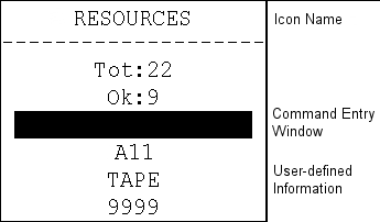

Icons on the graphical monitor group resources together. Icons can group different types of resources, and can group resources from different systems.
Typically, each icon is identified by a name. You can enter commands in the command entry window. The following shows an icon and the information it contains.
An icon may display other information (for example, the resource states).
