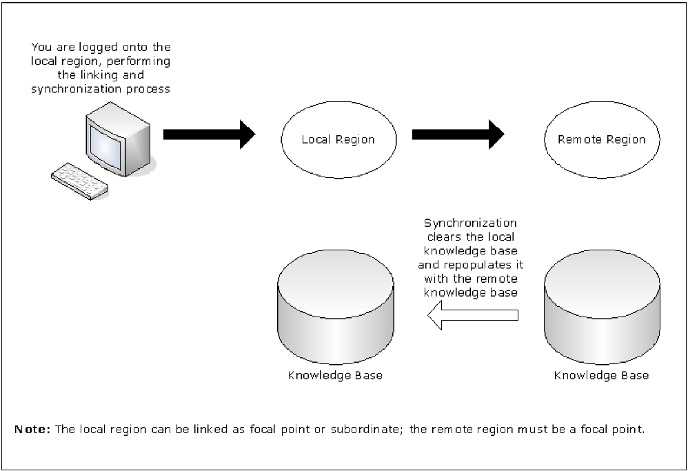

When you link two regions, the local region in which you perform the link operation receives the knowledge base from the remote region you want to link to, which must be a focal point region. When you link a region into an existing multisystem environment, that region must be a stand-alone region.
Important! During the linking and synchronization process, the knowledge base in the local region is overwritten by the knowledge base from the remote focal region. If the local knowledge base has been customized and contains definitions that you want to retain in the synchronized knowledge bases, you must transmit these definitions to the remote knowledge base before you link the regions; otherwise, the local knowledge base definitions are overwritten and lost.

The following illustration shows the link and synchronization operation.
After you link the regions, the knowledge bases are synchronized and remain synchronized. If you change the knowledge base in one region, the changes are propagated to the other regions.
