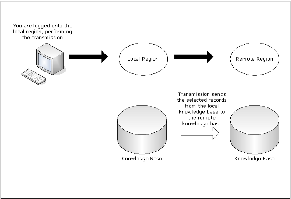

You can transmit, that is, copy knowledge base records from the local region to a remote region that is not linked to it.

The following illustration shows the transmit operation.
