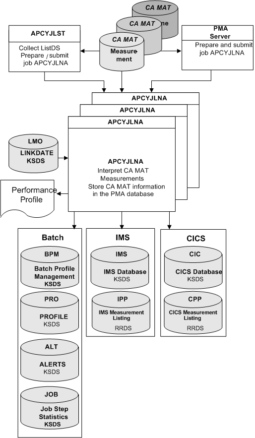

After CA MAT has performed a measurement, CA MAT creates the List Dataset. Job APCYJLST evaluates the CA MAT measurement that resulted from generated measurements. To get the measurement, a program must be called. Job APCYJLNA contains a procedure to do so. Additionally, a program is called to interpret the measurement. Performance Management Assistant saves or discards a measurement depending on the consumption during the step's execution, user defined parameters, and alert reasons. The measurements are kept or deleted as determined by the deete processed sample ds parameter. Job APCYJLST automatically creates and submits APCYJLNA jobs as many times as needed to process all measurements.
Job APCYJLST has the following scheduling considerations:
In order to get the measurement results available in Performance Management Assistant as soon as possible, the Server submits job APCYJLNA any time a measured job step has terminated. If you use this functional benefit, job APCYJLST is needed only for measurements that are not controlled by Performance Management Assistant and for the CICS and IMS/DC measurements.
Since all measurements of CICS or IMS/DC regions must be processed in one APCYJLNA job, job APCYJLST must be provided with the names of the regions. CICS and IMS/DC add monitor invokes for CA MAT. CA MAT creates List data sets from the Monitor data sets and these List data sets are interpreted by job APCYJLST for the regions identified in the following members:

The JCL for job APCYJLNA is found at DDNAME INTUPROF of job APCYJLST. It is input to the internal reader. Make sure that the job card of APCYJLNA is customized to fit your environment.
