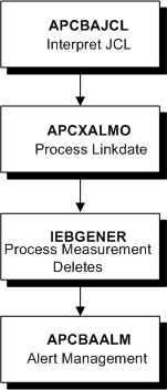

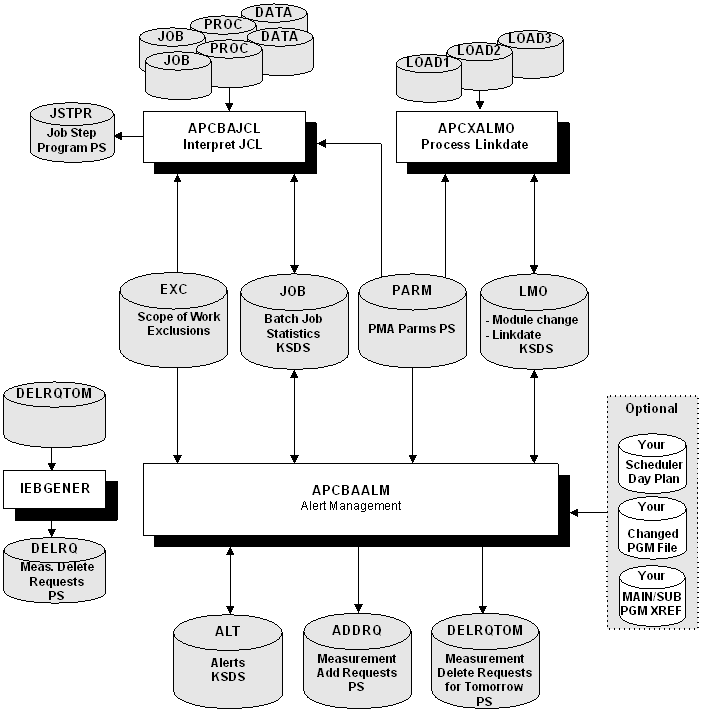

The data flow of APCXJLIB is illustrated in the following flowchart followed by an illustration of the job step sequence.
The following example is an illustration of the job step sequence for job APCXJLIB. Each of these job steps is detailed in subsequent sections.
