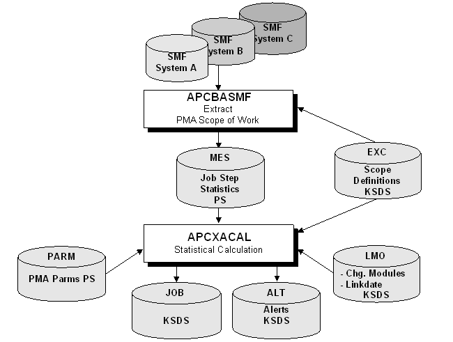

Job APCXJSMF
Job APCXJSMF gathers information about executed job steps from SMF Type 30 records (subtype 4). Your Scope of work definitions are used to determine which jobs to view. Using this information, Performance Management Assistant calculates statistical values for consumed elapsed time and service units and checks if the last job step execution exceeded them. If it finds a runaway, a pending alert is created. This job also checks the SMF consumption values against the defined alert thresholds; see Thresholds for Reducing Measurement Activities.
Job APCXJSMF has the following scheduling considerations:
Job APCXJSMF consists of two steps, APCBASMF and APCXACAL, illustrated following.
Flowchart of job APCXJSMF
