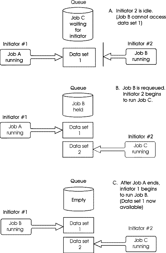

First, ECMF detects whether all requested resources are currently available to a batch job. If not, then ECMF issues MIM1038/MIM1039/MIM1040 messages until the REQAFTER value expires. At this time, CA MIM executes the JES2 commands to requeue the batch job. Specify the REQAFTER option on the SET ECMF command in the commands member. The value for this option is the number of REPORTCYCLEs on the SYSDSN QNAME that ECMF must wait before it requeues the batch job.

After these commands are issued, the job is removed from the initiator, and stays in the HELD queue until the resource becomes available. The following message displays:
MIM1083 jobname(jesid) REQUEUED - AWAITING DATASETS
ECMF determines resource availability, both locally and globally, of all required resources for all DD cards in the JCL of the batch job. This check is performed every REQCYCLE, as coded on the SET ECMF REQCYCLE command. The default is 30 seconds. After ECMF determines that ALL resources are now available, it executes the $Ajxxxxx JES2 command to release the batch job.
The following message is issued:
MIM1048 jobname(jesid) RELEASED - DATASETS NOW AVAILABLE
The following graphic illustrates this process:
