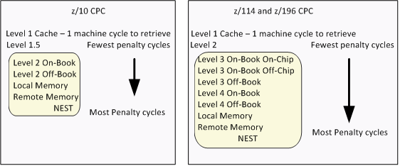

A design objective of IBM mainframe CPC’s is that when an instruction or datum is fetched from the IPU level 1 cache, the retrieval completes in a single machine cycle. With the introduction of the IBM z/10 CPC, the CPC cycle rate increased dramatically from the 1.7 GHz rate of the previous z/9 CPC to 4.4 GHz. At this significantly higher cycle rate, the Level 1 data and instruction caches had to be reduced in size to continue to meet the one cycle retrieval objective.
Beginning with the z/10, and continuing with the z/196 (5.2 GHz), to maximize CPC performance, IBM introduced additional layers of cache between the Level 1 cache and real memory. The number of machine cycles required to retrieve an item from these intermediate cache levels increases from level to level, with the worst performance occurring when the item must be retrieved from remote memory, where it can take several hundred machine cycles for retrieval. The machine cycles expended while attempting to find and retrieve a required datum or instruction are referred to as penalty cycles:
