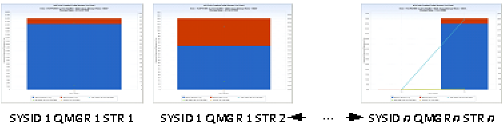

MQ Daily CF Structure Use Summary
Left Y-axis
CMSMXELE – Maximum Elements in Use
CMSMXENT – Maximum Entries in Use
Right Y-axis
CMSCSEC – Single Update Calls (IXLLSTE)
CMSCMEC – Multiple Update Calls (IXLLSTM)
CMSSTFUL – Structure Full Count
X-axis
CMSSTRNM – Structure Name

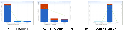

MQ Daily CF Structure Use Detail
Left Y-axis
Right Y-axis
X-axis
HOUR – Hour of Day
