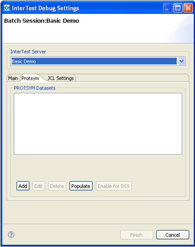

  3. Select the PROTSYM tab.
    A dialog in which you can select protsym files.
  4. Click Add, and add CAI.PROTSYM as the PROTSYM data set name, or the data set name provided by your CA InterTest administrator, in the Add Dataset Name dialog. Click OK.
    The data set name appears in the PROTSYM Datasets area.

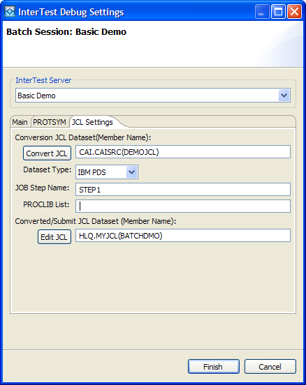

  5. Click the JCL Settings tab.
    The InterTest Debug Settings dialog opens.
  6. Complete the following fields:
    The following illustration shows the completed dialog:
    A dialog in which you specify your batch settings.
  7. Click the Convert JCL button.
    The converted JCL will be placed in HLQ.MYJCL(BATCHDMO).

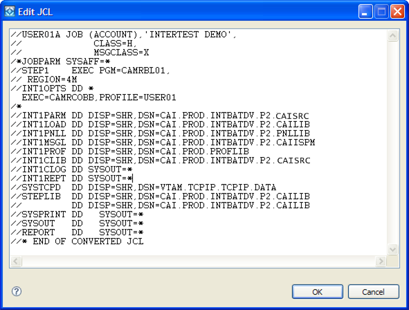

  8. After the JCL conversion is complete, click the Edit JCL button to edit the converted JCL.
    The Edit JCL dialog opens.
    JCl for batch link demo, which you can edit.

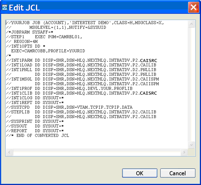

  9. Make the following changes to the Edit JCL dialog:
    The following illustration shows the edited JCL:
    The edited JCL for a COBOL Batch program.
