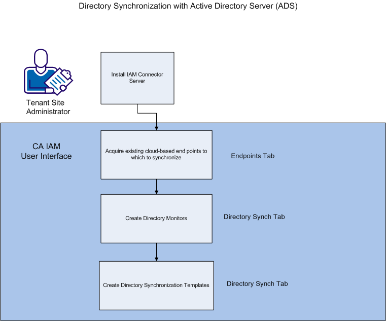

To set up directory synchronization, follow this process:
  1. Install CA IAM CS in your environment.
  2. Acquire the endpoints that you want to synchronize with. Consult the appropriate connector configuration documentation. You must acquire endpoints in order to create templates in step 4.
  3. Create one or more directory monitors. Monitors capture changes that you make in your local Active Directory, and report them for the synchronization.
  4. Create one or more synchronization templates. Templates control settings for the directory synchronization.
CM_1.1--AD_Provision--VISIO
