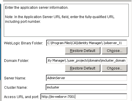

  4. When you reach the WebLogic section, complete it as follows:
    WebLogic Binary Folder
    The location of the application server home directory.
    Domain Folder
    The name of the WebLogic domain you created for Identity Manager.
    Server Name
    The name of the WebLogic server on which the domain is configured.
    Cluster Name
    The name of the cluster.
    Access URL and port
    Supply the URL and the port number for the web server used for load balancing.
    WebLogic Cluster Installl
