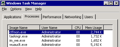

- Verify that all of the following Ingres processes are stopped (use the Window Task Manager or the UNIX ps command):
- dmfacp.exe
- dmfrcp.exe
- iidbms.exe
- iigcc.exe
- iigcn.exe
- iijdbc.exe
- iistar.exe

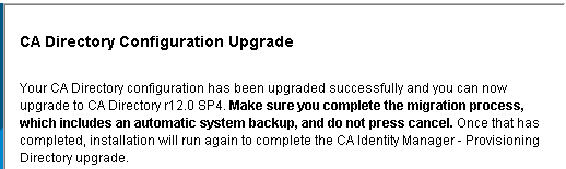

- If you are upgrading a pre-r12.5 installation, a CA Directory Upgrade Configuration appears:
- Click Finish to perform the CA Directory upgrade. Note the following:
- The CA Directory starts by backing up your current installation when you click Migrate.
- Select a Typical installation type when prompted during the CA Directory upgrade.
- Due to architectural changes effective in CA Directory r12 SP1 and higher, reporting databases and unnecessary DSAs are removed before the CA Directory upgrade.
- During CA Directory installation, you are asked for information about installing DXadmind for DXManager, however, you can safely uncheck this option. The Provisioning Directory does not use DXManager.
Once the CA Directory upgrade completes, the Provisioning Directory upgrade resumes.

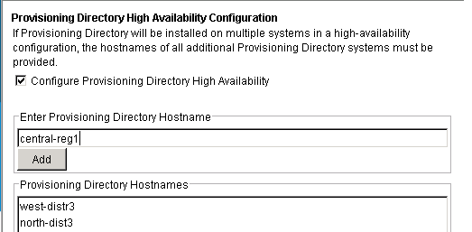

During upgrade, you can select a check box to configure Provisioning Directory high availability. If you choose this option, you supply the hostnames of all alternate Provisioning Directories and specify the primary Provisioning Directory.
- When the upgrade completes, uninstall and reinstall any alternate Provisioning Directories. For more information, see the Installation Guide.
