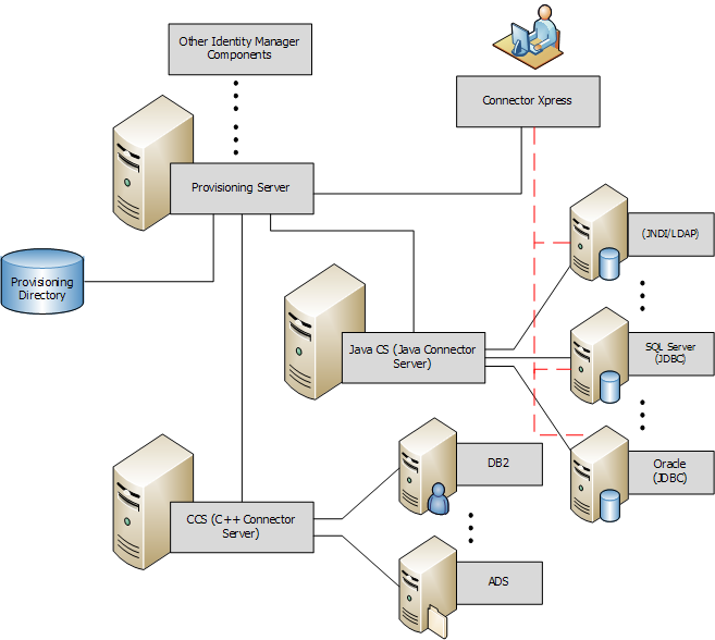

Communication with Other Components
The following diagram shows the direct and indirect communications between Connector Xpress and other components in the distributed system:
Communication with other Components
Note: The dashed red lines indicate that the direct communications between Connector Xpress and endpoints are read-only. These direct communications occur when setting up data sources.
