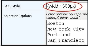

You can use this field to set the width of a field. For example, to set the width of a field with the Drop Down style to 300 pixels, you specify the following in the CSS Style field:
Note: By default, the width of fields that include a list of values, such as a drop down or multi-selector box, is set to auto ({width:auto}). This setting sizes the field to accommodate the largest value in the field. For example, if the largest value in the City option selector field is San Francisco, the option list is sized to display the entire value.
You can also use the CSS Style field to control other display properties, such as text size and background color.
