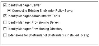

  4. Complete the Select Components section by including the Identity Manager Server and any other components that you need on this system.
    select_components

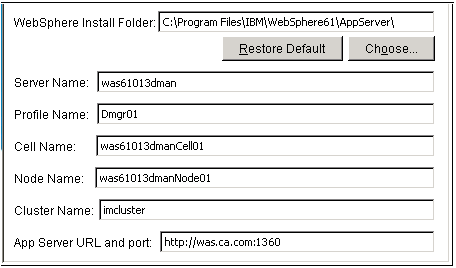

    The WebSphere section includes these fields:
    WebSphere Install Folder
    The folder or directory where WebSphere is installed. You find this location in the Windows or UNIX file system.
    Server Name
    The first cluster member in the WebSphere cluster. You find this name in the WebSphere console.
    Profile Name
    The deployment manager profile. You find this name in the Windows or UNIX file system at the path:
    was_home/profiles/Deployment_Manager_Profile/config/cells/
    Cell Name
    The deployment manager's cell which can be found in the WebSphere console.
    Node Name
    A node that contains the Server Name you supplied on this screen. You find this name in the WebSphere console.
    Cluster Name
    The name of the cluster. You find this name in the WebSphere console.
    App Server URL and port
    The URL and port number of the Web Server used for load balancing.
    IM-WebSphere-Install
