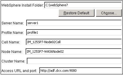

  6. Supply the details for the websphere 7 that you created.
    was_details_sa
    The WebSphere section includes these fields:
    WebSphere Install Folder
    The folder or directory where WebSphere is installed. You find this location in the Windows or UNIX file system.
    Server Name
    You find this name in the WebSphere console.
    Profile Name
    You find this name in the Windows or UNIX file system at the path:
    was_home/profiles/Deployment_Manager_Profile/config/cells/
    Cell Name
    The deployment manager's cell which can be found in the WebSphere console.
    Node Name
    A node that contains the Server Name you supplied on this screen. You find this name in the WebSphere console.
    Access URL and port
    The fully-qualified system name and port number used by WebSphere.
