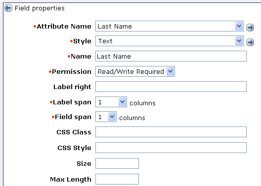

You select a field to edit its properties. Each field style has different properties, which define the display, permissions, and defaults for that property.
The following example shows the field properties that appear when you edit the Last Name field.
Note: The properties that are displayed in the Field Properties screen are determined by the option you select in the Style field. You may not see all of the properties described in this list.

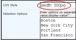

Specifies the Cascading Style Sheet rules that control the presentation of this field.
You can use this field to set the width of a field. For example, to set the width of a field with the Drop Down style to 300 pixels, you specify the following in the CSS Style field:
