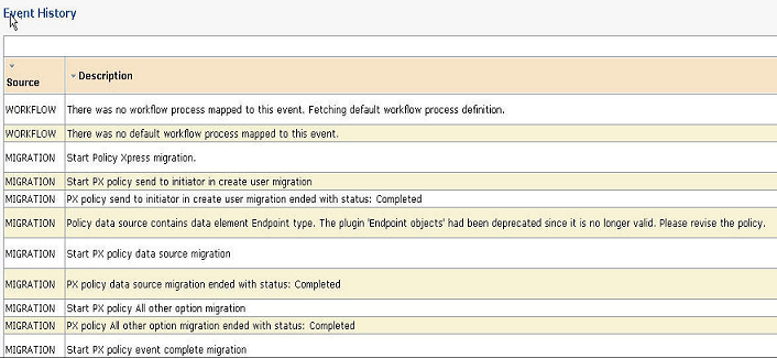

View Migration Details
When you run the Option Pack Migration task, it appears in View Submitted Tasks. To view the migration details, drill into the task and click the Event 'Option Pack Migration'. These details describe the Option Pack components that are migrated, and outline any outstanding issues that occur during migration that may require additional manual steps.
We recommend reviewing these details to identify which components require manual updates to work correctly in CA Identity Manager r12.5 SP1. For example, changes to Policy Xpress policies that used plug-ins that no longer exist in SP1.
The following graphic shows an example of the migration details that appear in View Submitted tasks:
PX Migration VST
