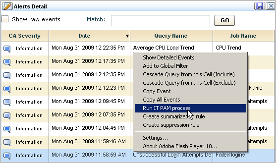

  5. Select the query result row for which you want to run the CA IT PAM process.
  6. Right-click this query result row and select Run IT PAM process from the drop-down list.
    Select Run IT PAM process.

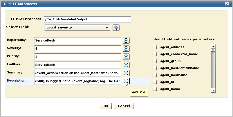

    The Run IT PAM process dialog appears. It contains the process name and process parameters defined in the IT PAM configuration of the Report Server service. Additionally, it contains a Select Field drop-down list that allows you to enter variable data returned to the selected CEG field.
  7. Complete the fields as follows:
    1. Review the default values shown for the displayed process parameters and identify any values that need to be changed.
      These parameters and their values are derived from the CA IT PAM integration configuration.
    2. To change the displayed default value, type the new value.
    3. To specify a variable value, select that CEG field from the Select Field drop-down list at the top of the dialog, then click Add Field next to the text box to which it applies.
    4. For any field that is blank, type a value, select a variable and add it, or type a sentence that includes selected variables.
      Example Summary: On (event_datetime), the (dest_username) account performed a (event_action) action on the (dest_hostname) host.
      Example Description: The action result (event_result), is logged in the (event_logname) log. The CA Severity is (event_severity).
    5. If the CA IT PAM process specifies parameters that refer to additional CEG fields, select these fields from the displayed list to send as parameters.
    An example follows. Your display may include other fields defined in the custom IT PAM event/alert output process.
    Override default values and enter strings with variables, as needed.

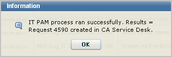

    The progress dialog appears, followed by a message indicating whether the CA IT PAM process ran successfully, and if so, the results of running the process.
    An example follows, where the result is Request 4590 created in Service Desk.
    Example information message for successful run includes the request number.

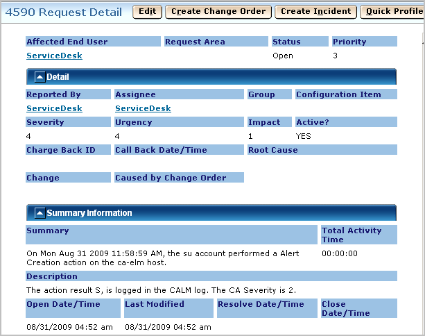

  10. To see the results in CA Service Desk, log on and search for "Request" with the number in the message.
    For example, select Request and enter 4590.
    Enter Request and enter the ticket number.
  11. Service Desk results similar to the following appear.
    The Service Desk displays the summary and description information with data for the variables you entered.
  12. Compare the planned summary and description data determined in Step 7 with the summary and description data displayed under Summary Information. It includes the CA Severity data.
