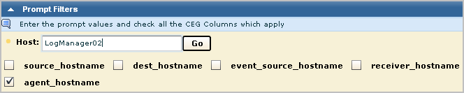

  3. Submit a query for events collected by the default agent.
    1. Enter the default agent host name in the Host field, which is also the name of the CA Enterprise Log Manager on which it resides.
    2. Select agent_hostname.
    3. Click Go.
      Select agent_hostname and click Go.

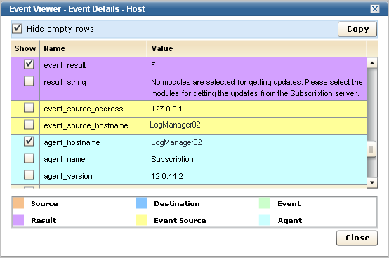

  4. Display the results to examine.
    1. Click the Results column to sort by results.
    2. Scroll to the first result of F for failure. Assume it is a configuration warning in the category Configuration Management.
    3. Double-click to select the row to view in detail.
    The Event Viewer appears.
  5. Scroll to the area where the Result is displayed. In the example, the error is a warning that you need to configure the subscription module. This is a warning you should ignore until you have finished installing all of the CA Enterprise Log Manager servers you plan to install.
    The event viewer displays the results.
