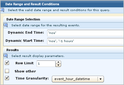

  7. Click Result Conditions to override the ones set in the query definition.
    1. To specify the alert should evaluate the disk space for the past hour, enter the date range as 'now' for Dynamic End Time and 'now' '-1 hours' for Dynamic start time.
    2. To specify that you only want to be notified if the query returns a result; and you want to see only the first result returned, select Row Limit and select the value 1. Since the dynamic time range is in hours, select event_hour_datetime as the Time Granularity.
    3. Leave Grouped Events blank since that does not apply to this query.
    Screen showing Date and Range Conditions for the action alert job.

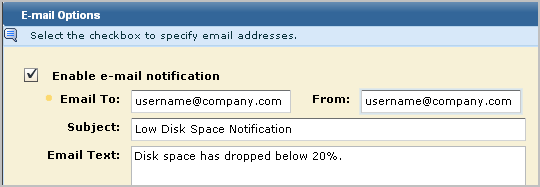

  9. Click the Destination step. Select enable-email notification; enter your email address in the Email To field. Optionally, enter a subject and email text. Or, email it to the desired recipients and enter your email address in the From field. If you enter multiple email addresses, separate them with a comma (not a semicolon).
    Screen showing Email Options for the action alert.

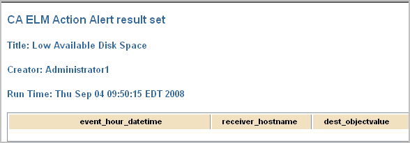

You will receive email notification as requested. An example follows:
Sample output of from the query.
