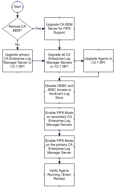

This illustration shows the steps in upgrading CA Enterprise Log Manager servers and agent for FIPS support.
The upgrade and FIPS enablement process includes the following steps:
  1. Upgrade the primary or Management server to r12.1 SP1.

  2. Upgrade all other CA Enterprise Log Manager servers in the federation to r12.1 SP1.
  3. Upgrade all the agents to r12.1 SP1 and update the connector log sensors as needed.

  4. Disable ODBC and JDBC access to the event log store.
  5. Enable FIPS mode on each of the secondary CA Enterprise Log Manager servers in the federation.
    Agents automatically detect the operating mode from the CA Enterprise Log Manager server that manages them.
  6. Enable FIPS mode on the primary or Management server.
  7. Verify that the agents are running in FIPS mode using the Agent Explorer dashboard.
