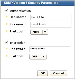

    2. Click V3 Security.
      The SNMP Version 3 Security Parameters dialog appears.
      Important: The entries on this dialog must match the settings in snmpv3.dat that you configured to enable CA NSM to receive SNMP traps from CA Enterprise Log Manager alerts. The recommended setting follows:
      *.*.*.* *:*   <username>:AuthPriv:MD5:<password>:DES:<password>
    3. Select Authentication. Type the configured user name for username, type the configured password for password, and select MD5 for protocol.
    4. Select Encryption. Type the configured password for password and select DES for protocol.
    5. Click OK.
      An example follows:
    Enter the v3 security parameter configuration.

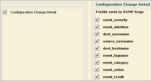

  7. Select the query to send as an SNMP trap.
    In this example, when you select Configuration Change Detail, the fields for that query are displayed as selected. Optionally, you can clear any field you do not want included as a trap.
    Important! When you create a custom MIB for this alert, be sure to define a trap with the fields you select here and in the order shown.
    You can clear any query field you want excluded.
