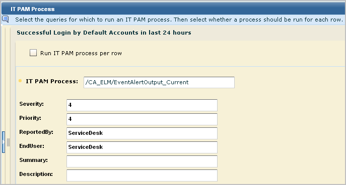

  6. Define the alert data to pass to the IT PAM process along with the event data retrieved by the query.
    1. Click the Destination step.
    2. Select the IT PAM Process tab.
    3. Select the query to send
    Select the checkbox next to the query to run.
    1. If you want results reported by query, leave the Run IT PAM process per row blank.
    2. Optionally, type literal text in the Summary and Description fields.
      Make no entries.

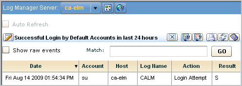

      The CA Enterprise Log Manager logon dialog appears.
    2. Log into CA Enterprise Log Manager. You can use an account with a low-privilege role such as Auditor.
      The event data returned by the query is presented in the format of the default view of the query, that is, table or chart.
    View the tabular display of the event data.
    If the display is in table format, you can view raw event data.
