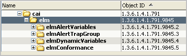

    CAELM-MIB is added to the Navigation bar under CA.
    Navigation bar shows CAELM-MIB under CA.
    In the hierarchy, cai expands to display elm with its subordinate tree objects and their associated OIDs.
    CAELM-MIB in CA Spectrum
