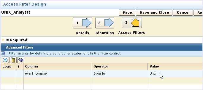

  8. Click New Event Filter Add button to add a line, and then click the field area under Column.
  9. Select event_logname from the drop-down list, and then click the field area under Value.
  10. Select Unix from the drop-down list. Your dialog resembles the following:
    This illustration shows the completed advanced filter page of the Access Filter Design wizard.
