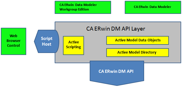

The API combines number of components and presents them as a set of interfaces accessible using COM.
The list of integrated components includes CA ERwin Data Modeler and Microsoft Internet Explorer.
ERwin API integrated components diagram
