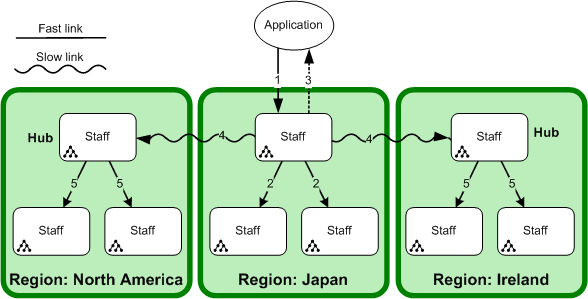

The following diagram shows a backbone with one namespace partition (Staff) across three regions:
The diagram shows the following steps:
  1. Write to self: A client sends an update request to a DSA, which applies the update to itself.
  2. Write to peers in region: If the local update succeeds, the DSA sends the request to its peers in the same region. If these updates succeed, the peers send confirmations back to the first DSA.
  3. Send response to client: When the first DSA has received confirmation from each peer in its region, it sends the confirmation response to the client.
  4. Write to hub DSAs in other regions: The first DSA sends the request to the hub DSAs in each of the other regions.
  5. Hub DSAs write to peers: Each hub DSA sends the request to the other DSAs in its region.
    The following steps are not shown in the diagram.
  6. Peer DSAs write to self: Each peer DSA makes the update.
  7. Peer DSAs send confirmation to hubs: Each peer DSA sends confirmation of the update to the hub DSA.
  8. Hub DSAs send confirmation to the first DSA: Each hub DSA sends the confirmation response to the first DSA. This DSA has already sent confirmation back to the client, so the client is not affected by the slow links.
