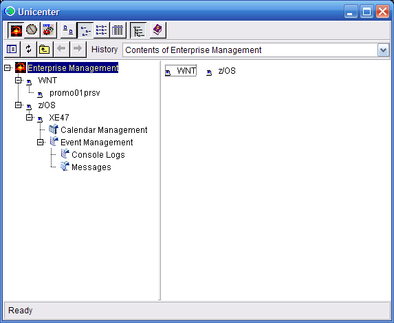

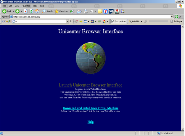

  4. Connect to the GUI.
  5. Enter a mainframe user ID and password.
  6. Click OK to display the main CA NSM GUI.
    CCS BPG - Verify Your Installation step 6
