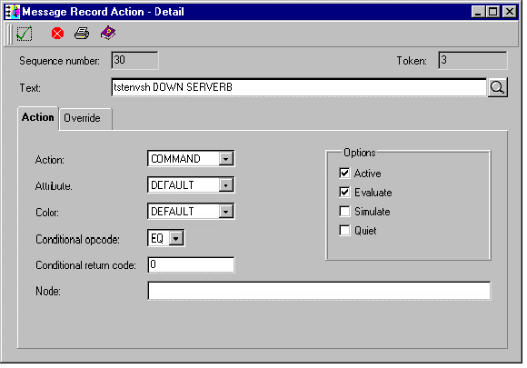

The Message Action Detail action of COMMAND can be used to run a program or shell script. To perform this type of processing, you can execute the script tstenvsh as follows using the action COMMAND to test the contents of a previously set variable.

Following is an example of the Message Record Action-Detail screen defined to test if a variable SERVERB has the value of DOWN.
BPG-EM-SERVERB
