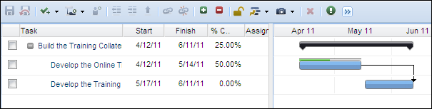

By Example: Building a WBS
You create a summary task named Build the Training Collateral that contains two detail tasks: Develop the Online Training and Develop the Training Quiz. You create the three tasks, and indent the detail tasks one level under the summary task.
