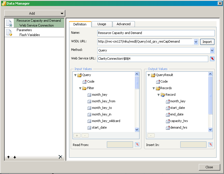

The following figure shows the Data Manager with a basic external data connection setup:
Illustrates the set up for a Web Service Connection

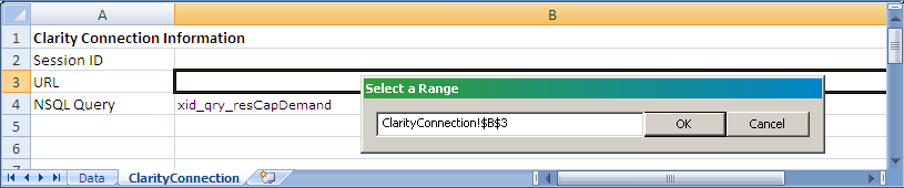

The following figure illustrates the corresponding, embedded spreadsheet for the web service connection:
This illustrates the spreadsheet for the web services connection
