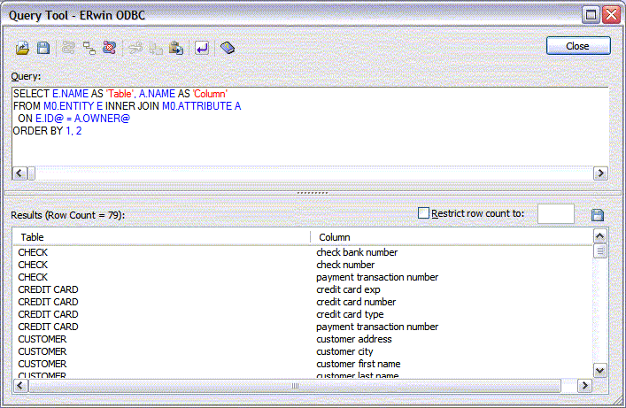

To illustrate this, the ATTRIBUTE table would have columns such as NAME, DEFINITION, DATATYPE, NULL_OPTION, and so on. You can use a query similar to the following to determine the names of all the Attribute objects in your model.
Example: Query for returning the list of names of all the Attribute model objects
