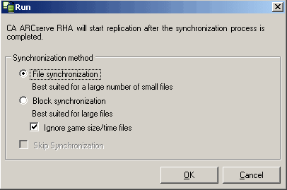

  3. Click Run. Use the Advanced button to display scenario details of the Master and Replica.
    The Run dialog opens.
    No Skip Sync
    Note: When you start UNIX-based scenarios, you cannot skip file/block synchronization.
  4. Choose File synchronization and click OK.
    Note: If you are running a scenario for an Oracle server, remove the check from the Ignore same size/time files check box and select Block Synchronization.

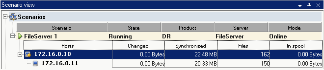

    The Manager now indicates that the scenario is running by the green play symbol to the left of the scenario:
    Starting a scenario using the GUI in the Scenario View

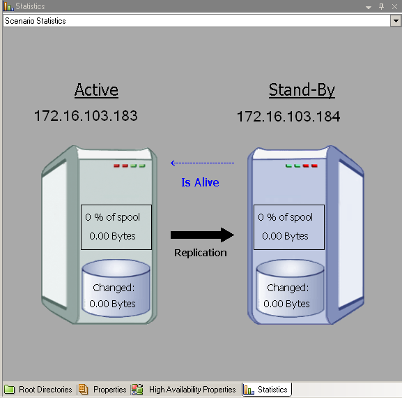

    Once a scenario is running, a Statistics tab appears (on the bottom of the far right pane):
    Starting a Scenario Using the GUI-Scenario Statistics View
