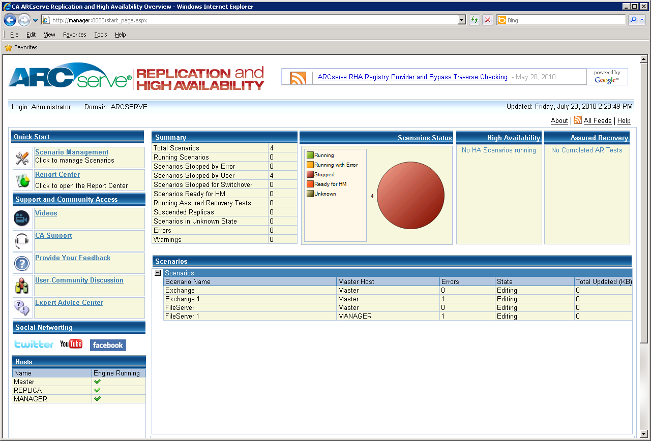

Important! To log in to the Management Center, you must be a member of the Administrators Group on the Local machine where the Control Service is installed.
The Overview page appears.
