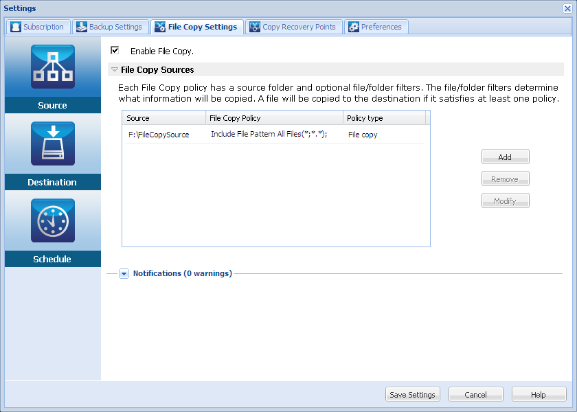

  1. From the CA ARCserve D2D On Demand home page (or CA ARCserve D2D On Demand Monitor), select Settings from the taskbar and then select the File Copy Settings tab. When the File Copy Settings dialog opens, select Source.
    The File Copy Source dialog opens.
    File Copy Settings - Source Dialog
  2. Specify your file copy source settings.
    Enable File Copy
    Enables the scheduled copying of files after the specified number of backups. If this option is not selected (File Copy disabled), no scheduled file copying is performed and any changes to the File Copy settings are not validated and saved.
    File Copy Sources
    Displays a selectable listing of all sources, with the corresponding policy (filters) and type of file copy (copy and retain or copy and move) to be performed after each successful CA ARCserve D2D On Demand backup. These File Copy Sources can be added, removed, or modified.
    Note: CA ARCserve D2D On Demand does not copy application files, files with system attributes, and files with temporary attributes.
    • Add Source
      When clicked, the Policy type dialog opens to let you initially select the type of file copy job to perform (copy and retain or copy and move). After you select the policy type, the corresponding File Copy Policy dialog opens to let you add a source to copy and specify the corresponding policies for that source. For more information, see Specify File Copy Policies.
      Note: The File Copy source can only be chosen from a volume that is currently selected in Backup Settings.
    • Remove
      When clicked removes the selected source from this displayed list.
    • Modify
      When clicked, the File Copy Policies dialog opens to let you change the policy settings for the selected source. For more information, see Specify File Copy Policies.
  3. Click Save Settings.
    Your File Copy settings are saved.
