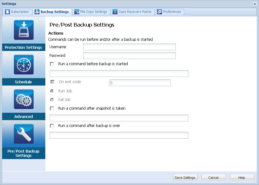

  1. From the CA ARCserve D2D On Demand home page (or CA ARCserve D2D On Demand Monitor), select Settings from the taskbar and then select the Backup Settings tab. When the Backup Settings dialog opens, select Pre/Post Backup.
    The Pre/Post Backup Settings dialog opens.
    caadr--Backup Configuration - Advanced Settings-W
  2. Specify your pre/post backup setting options.
    Actions
    Runs script commands for actions to take prior to the start of the backup, after the snapshot image is captured, and/or upon the completion of the backup. You can also trigger the script command based upon specific exit codes and select the action to be taken (run job or fail job) when that exit code is returned.
    • A "run job" action directs CA ARCserve D2D On Demand to continue to run the job if the specified exit code is returned.
    • A "fail job" action directs CA ARCserve D2D On Demand to cancel the job if the specified exit code is returned.
  3. Click Save Settings.
    Your pre/post backup settings are saved.
