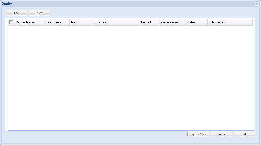

  1. From the CA ARCserve D2D On Demand home page, select Deploy.
    The Remote Deployment dialog opens.
    Remote Deployment
  2. Click Add.

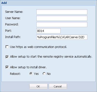

    The Add dialog opens.
    Remote Deployment - Add
  3. Enter the following information:
    1. Server name where CA ARCserve D2D On Demand will be deployed to.
    2. A valid User Name and Password to access the selected server.
      The user name should be given as <machine name>/<username>
    3. Port number. This port number is used to connect to the web-based UI.
      By default, the port number is 8014.
    4. Installation path on the remote server for CA ARCserve D2D On Demand.
      By default, this location is %Program Files%\CA\ARCserve D2D On Demand
    5. Specify if you want to use https as your web communication protocol.
    6. Specify if you want the required reboot to be performed automatically upon completion of the deployment process or if you want to reboot manually at a later time.
      A system reboot is required (now or later) for the remote deployment of CA ARCserve D2D On Demand to take effect.
      Note: During remote deployment if for any reason a reboot is not required, CA ARCserve D2D On Demand will not reboot even if you have selected automatic reboot after deployment.
    7. Specify if you want the setup to start the remote registry service automatically.
  4. Click OK to close the Add dialog.

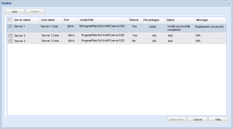

    After you click OK, the deploy tool checks whether the remote machine can be accessed with no problems. If no error is reported, then the server is automatically added to the remote deployment list. If an error is reported, you are notified of the appropriate error and the server is not added to the remote deployment list.
    The Remote Deployment dialog lists all related information for the added server.
    Remote Deployment - populated
  5. Select the server for remote deployment and click Deploy Now to launch the remote deployment process.
    A status message is displayed indicating if the remote deployment was successful or not. When the remote deployment is successful, you can access CA ARCserve D2D On Demand from that remote server; however, you can only perform backups on servers that are properly licensed.
    In addition the name of the remotely deployed server is now added to the Server drop-down list on the CA ARCserve D2D On Demand home page, which lets you quickly and easily manage or view the status of these servers.
